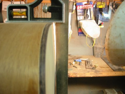

Think I messed up big time. Didn't realize it at the time but sanded the top rim with dish and assembled. I have a serious dip at the front where the neck attached. Put a square from the soundboard down the sides as the neck would attach and the dip is rougly 1/8". You can see from the pic what I am saying.
Wondering what to do??? Doesn't look like shaving the heel will fix this type of problem.

From the photo it looks like the neck angle is opposite of what it should be. Sort of like a neck in bad need of a reset. The fingerboard when clamped tight to the neck. and extended to the bridge area with a straight edge should measure about 3/8" above the body without frets. If you will check this then mabe we can find a way to fix it.

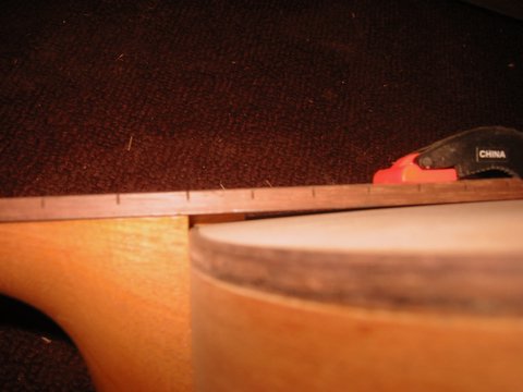

This pic shows the drop with a square
With the fret board positioned as such, I can get a good neck angle. Looks like I will have to make a tapered fingerboard or glue up a piece of something under the fingerboard and the taper it to fit the neck at this angle. Or should I make another neck and taper the neck?

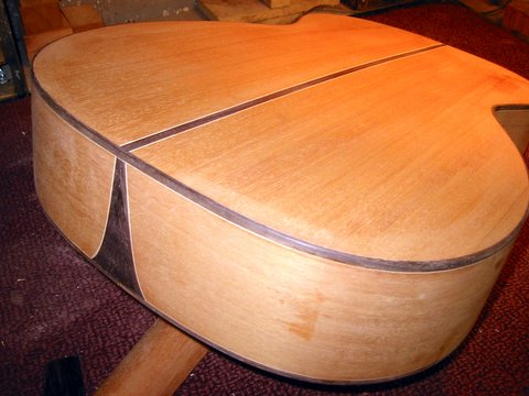

This makes me sick. The body came out flawless and has great tap tone to it. Here are a couple of shots. Mahogany back/sides, bearclaw top and rosewood bindings.

Your second picture still doesn't show where a straightedge
placed on the flat surface of the neck would fall at the bridge location. This is crucial information. It looks like there is a definite problem, but its hard to tell how much could be taken care of by gowing with a higher neck angle and a slightlyh raised saddle.

The straight edge falls perfect, just touching the bridge when the fretboard is positioned with the gap like in the picture. And with the fretboard held with a clamp at the first fret and also at the soundhole, it is level. That is what is leading me to think I could beef up the bottom of the fretboard and then taper it

From the second picture, it's definately the neck angle. Just work the heel down, and the gap on the neck, and on the top will close.

I agree with Al and Hesh, looking at this picture
there doesn't appear to be any set to the neck. So take your square and place one edge on the fb surface of the neck and run the other end down the heal end (the edge that bares on the body). If this is 90* than you don't have any set to the neck. YOU NEED TO SET THE NECK.
Now, if you have set the neck, than you have to shim and taper the end of the fret board like John, Joe and Walter have said.
The other thing that make me think there is no set to the neck is that all guitars have a dip at the front like this
Just think if it were 90* to the side of the body and you have the neck set (All necks need to have to be set back in order for the action to work properly), than you would have a very large shim under the fretboard or one very distinct dip in the fretboard.
So.... I think you need to set the neck back and everything will work out just fine.

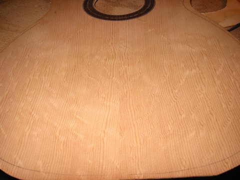

Oh, one thing you might want to do is sand the radius out of the top, see in this picture how the top appears to curve from the front of the body to the top of the sound hole?
That same radius is runs the latteral direction of the top as well. Now, some folks make a nice little sander 25' radius convex ( to sand the bottom of the fret board. But I think it's easier to sand the top flat instead. There are several ways to make the front part of the top, we won't get into that here though.

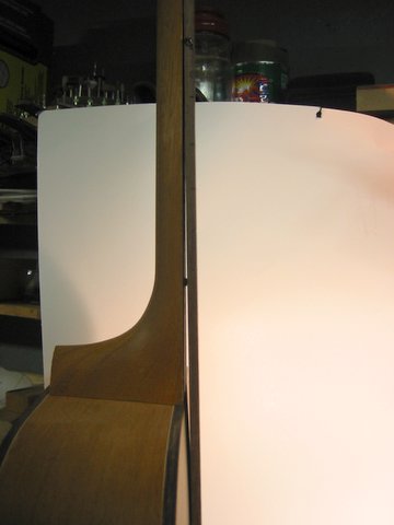

   This looks like you will solve this problem Rich. Body looks killer. I think your angle may be off. Can post 2 pixs on from the nut to the bridge and one with a side shot from the nut to the saddle

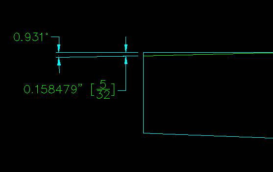

Remember, this is what rich said about the fret board,
[QUOTE=rich altieri]
If this is the case, than don't be afraid to trim the heal of the neck to match this angle.
Here, to prove my point, I layed out a 25' radius in Autocad to show that 1/8" is not a large dip at the front of the body.
The green line is the radius, and the blue lines are the guitar body. So if you sanded the rims with the apex of the radius at the center point of the body, you get a 5/32" dip (this is on a 20" body length) and about a 1* taper. So I don't think you will have any problem setting the neck here.

I did exactly this same thing on my first guitar -- sanded the rims to a 25' radius then glued on the top. When the neck was set at the proper angle to the bridge, there is a considerable gap as Rod calculated and Rich's photo illustrates (I'm betting the neck set is fine).
If the fb is layed flat on the top and neck is set to match, the neck set will be too steep (Rod, I bet you can tell us how much too high) because a 25' radius yields too steep an angle.
Having done this once, I now level the area above the soundhole flat (like Olson and others) to get the right angle before gluing on the top.
